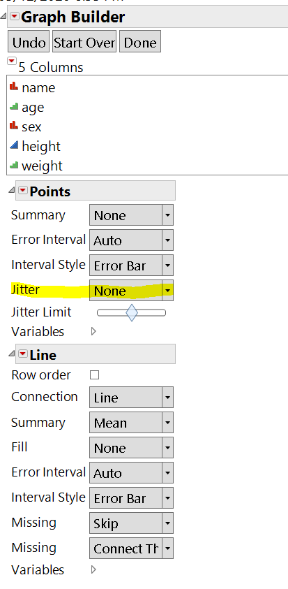

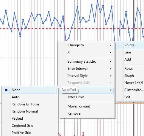

Also see if the jitter setting none helps.
Graph Builder's jitter settingGraph Builder's jitter setting

Craige_Hales
Re: points and lines in a graph
hi,
thanks for your help;
it' s better.
see the 2 images;
