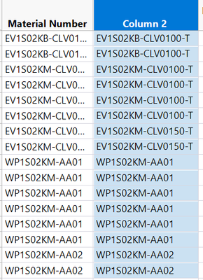

Hello, I would like to copy only the first 8 characters of the rows of the column Material Number  in the column 2.

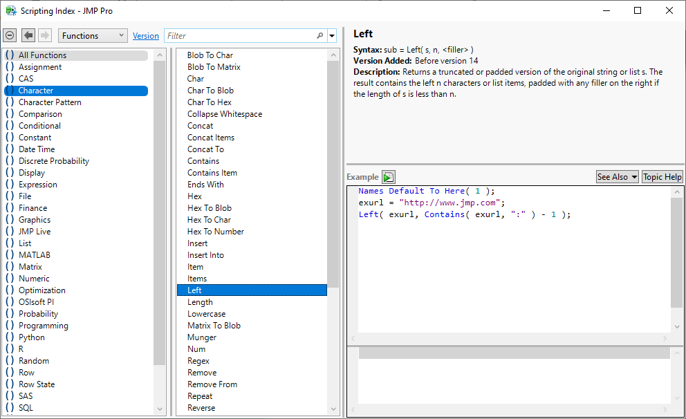

See the character string functions in the JMP documentation or Scripting Index:
The Left( string, number of characters) should work for this case.

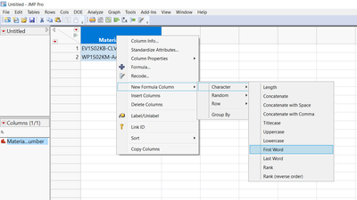

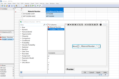

Another way (if you need the first part of the string befor the "-") would be to use the word function,
in a first step you can let JMP create the formula,
and then you need to set the word separating character to "-".
