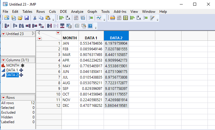

First the table:
Note that to have the correct order in the sequence of months, you may need to go to Column Properties > Value Ordering

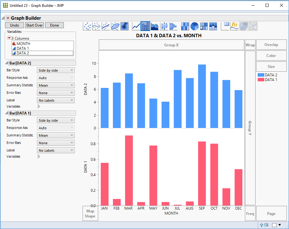

Here is the GB using this table:
  1. Drag the Month column to the X-axis area
  2. Drag Data 1 to the Y-Axis area
  3. Drag Data 2 to the top of the Y-Axis area
