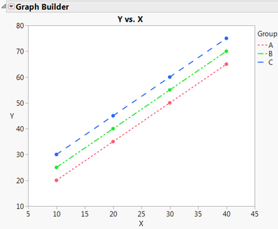

If you save the script and launch from there, it should retain the line and point customization you did previously, and assign default values to the new levels that you added.
For example, I have my overlay variable :Group with 3 levels (A, B, C).  The plot looks like this:Graph1.PNG

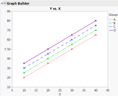

I save the script to my data table.
Now, I add a fourth level to :Group, "D".  Of course, this resets everything in Graph Builder I have currently as you describe.  However, if I run the script, I get my prior customization, plus a solid purple line for the new group "D".Graph2.PNG
