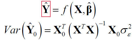

2. No. Are you considering something like a 1 or 2 SD interval? Such an interval is about the residuals, not about the predicted mean from the linear regression. the conventional intervals are not directly based on the SD of the residuals. The individual 95% confidence error bar presented with linear regression has a specific calculation and interpretation. It depends on the standard error of the predicted mean response and the associated t quantile. The standard error for a linear regression model is a quadratic form of your fitted model f and the model matrix X from the regression:
(This form is the quadratic equation you referred to.) It sounds like you won't be able to compute 95% confidence intervals as JMP does. You might be able to save the column formula for the interval in JMP and then fit a simple empirical polynomial that the web page can compute.

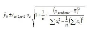

You'll notice the 0.0811942392532194 in your equation above. That is the RMSE^2. And, since it is multiplied within the sqrt() function, it can be factored out as RMSE.  So, that complex looking equation is some number, let's call it t*C (t =1.97569392781527, the critical value from the t dist), multiplied the RMSE. Now, C, in "simple linear regression" (Y = B0 + B1*X, where Y = log_ecoli and X = log_turbidity) simplifies to something you may find manageable. C is the square root term below (the Se term is the RMSE). The denominator in the third term in the sqrt term is just the sample variance of x multiplied by n-1. The numerator of that term is the squared difference between the log_turbidity value you want to predict at and the mean of all your log_turbidity values in the data set. Then, as @Mark_Bailey  indicated, just back transform the lower and upper to get back to your ecoli native scale. As he said, the resulting interval won't be symmetric (around exp(pred) ), but the percentiles carry over; i.e., the resulting Prediction Interval (PI)  is a PI around the median ( exp(pred) ) in the ecoli native scale (log normal). So, you add error bars before back-transforming, not after. Note: the formula below is for a prediction interval (an interval for a single predicted value). For a confidence interval (interval for the population mean), drop the first term, the "1", from under the square root. https://stats.stackexchange.com/questions/16493/difference-between-confidence-intervals-and-predicti...
C =
You could also then get and upper "error bar" via exp(upper) - exp(pred), and a lower "error bar" via exp(pred) - exp(lower) where upper and lower are defined as in the equation above. But, they won't have the same magnitude so it isn't exp(pred) +/-error...it is exp(pred) - lower error, exp(pred) + upper error.
