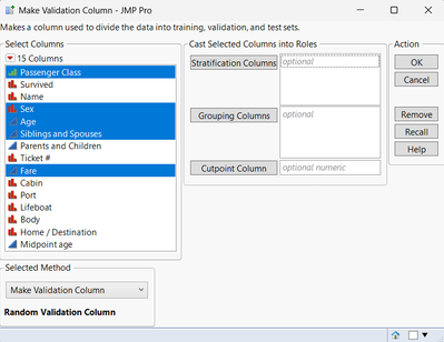

  1. First, go into the corresponding menu for creating validation column :
  2. Then you can specify groups or stratification (if needed) :
    You have several options for the method: here I used the default one corresponding to your needs, "Make Validation Column" and I use some variables as stratification columns to make sure all my training, validation and test sets will have a similar distribution/repartition of values for these columns.

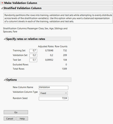

  3. Then you can specify the ratio of data for each of your sets, and specify a random seed to have perfect reproducibility in your data splitting. Here I choosed a fixed validation type, but you can also create a formula validation column, enabling to simulate various training, validation and test sets with the same settings (grouping, stratification, etc...) as specified in step 2. Here my data ratios are 70% for training, 20% for validation, and 10% for test (usual values, for more info and reasearch on this topic, you can read the paper "Optimal Ratio for Data Splitting" by V. Roshan Joseph: https://arxiv.org/pdf/2202.03326). It's important to find a good compromise for the ratios depending on the assessment accuracy/fairness and model selection needed, and the number of data/rows available. When you're done, click on "Go" to create this new validation column in your table :

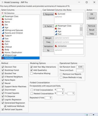

  4. Finally, launch the Model screening platform and use your newly created "Validation column" in the "Validation" panel. You can also fix a random seed at this stage to have reproducible results for the different models and sets used :
