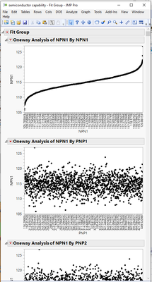

Here is one way of handling it
Names Default To Here( 1 );
// Open Data Table: semiconductor capability.jmp
// → Data Table( "semiconductor capability" )
dtWide = Open( "$SAMPLE_DATA/semiconductor capability.jmp" );
ERplot = fit group(
	Oneway( Y( :NPN1 ), X( dtWIDE<<get column group( "Processes" ) ) ),
	<<{Arrange in Rows( 1 )}

Morning, Well this *works* kinda.
Yes, it changes the output to a single column of plots, but the problem is now that they are oneway plots instead of bivariate plots. I can't figure out how to add fit lines and model Rsquared on a oneway...

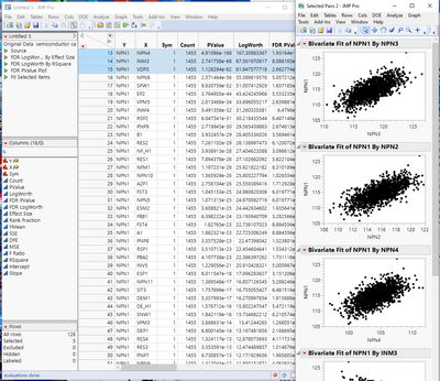

how to make this dynamic? I want to plot my output value Y (Etchrate) against a long group of input columns X (grouped cols) and display in a vertical window of graphs instead of a huge scroll left-right window.
txnelson
Re: make all Bivariate plots into a column, rather than a row?
  1. Which person are you replying to?  The code I provided in my last response
    ERplot = fit group(
    	bivariate( Y( :NPN1 ), X( dtWIDE<<get column group( "Processes" ) ) ),
    provides a vertical list of graphs, using a single x column and a variable grouping for the Y columns.
  2. There is also another platform that you may want to look at, Response Screening.  If you put in your X variable and Y grouping, it will generate a data table with all of the results listed in significance order.  You can then select from the list, and it will display the selected graphs in a vertical list.                     txnelson_0-1645805119971.png
