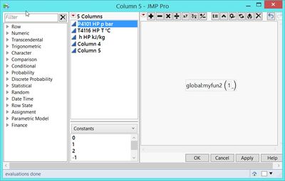

my approach is making a script and then attach this to an invisible add-in. Then use use the formulas in the pluging, in Formulas via global:myfunc().
If I have a single function on my script this approach works (see topic).
However, if I have two nested functions in one jsl script. This approach does not work anymore.

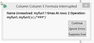

So what I would like to do in practice is call myfun2 from the Formula editor as follow:
but I get the following error:
Is there a way to do this?

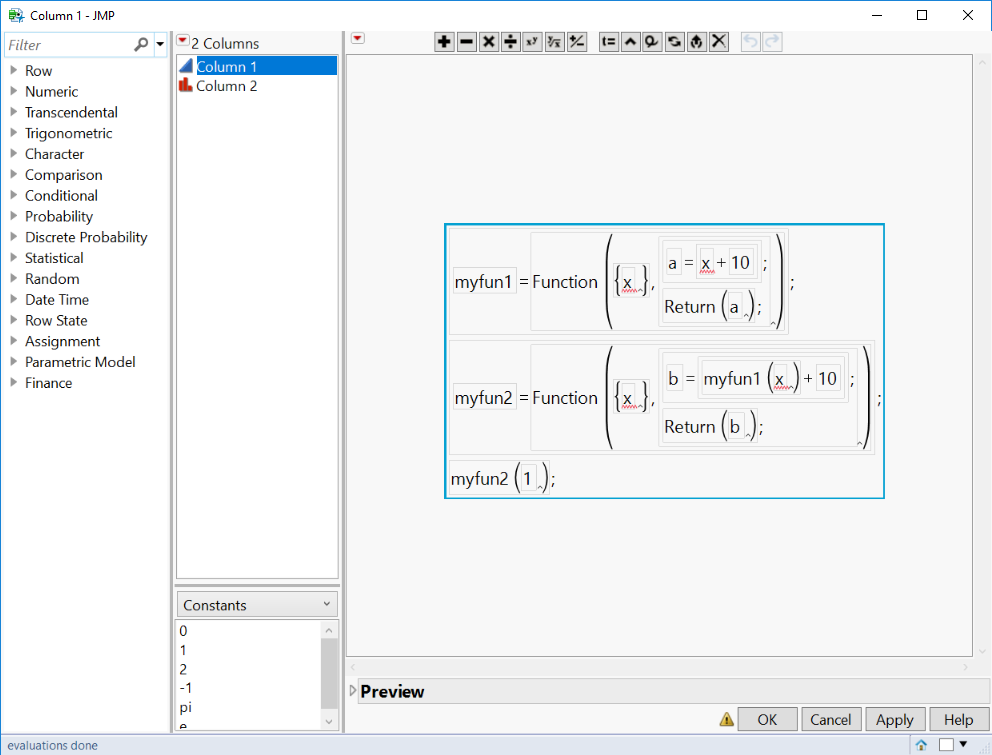

There's quite a few ways to approach this.  You could take an approach using expressions, for example.  Or you could put the definitions of myfun1 and myfun2 right into the column formula:Capture.PNG
Which is just pasting this into the formula:
myfun1 = Function( {x},
	a = x + 10;
	Return( a );
myfun2 = Function( {x},
	b = myfun1( x ) + 10;
	Return( b );
myfun2( 1 );
