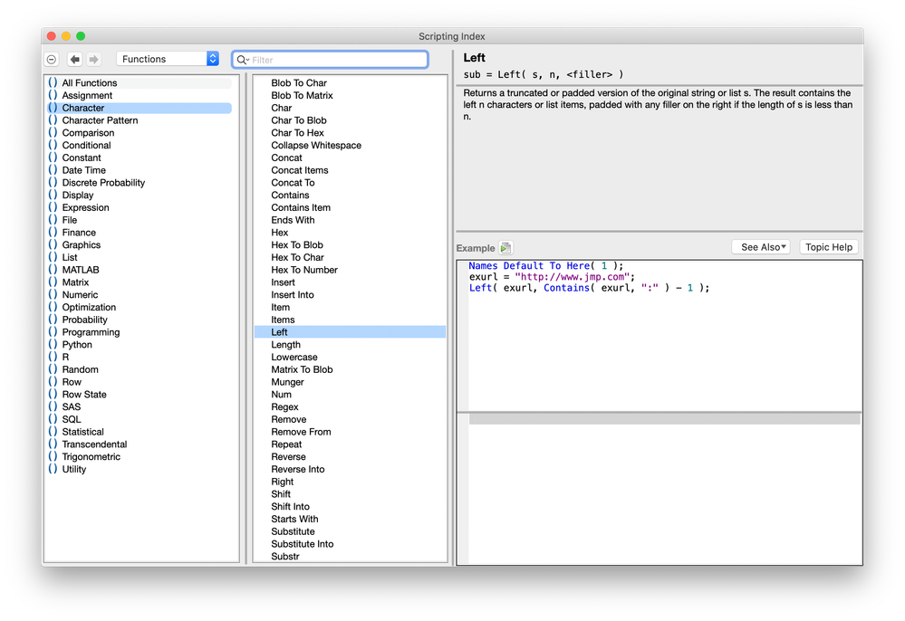

Re: looking for a formula
There is a built-in function for this result:
Of course for this example, it needs to be Right() so things are padded on the left.
Dan Obermiller
