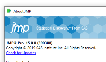

Thanks Jim. Interestingly it does not happen on JMP 12. I also tried it on another machine with a separate JMP install (Also JMP 15.0.0) and it does this double print.
The issue though is that it seems to run EVERYTHING which is part of a <<script() in this widget twice.
I'll see if I can update my JMP to > 15.0.0

Upgraded to JMP 15.1 and the issue is resolved.
Thanks Jim.
Jeff_Perkinson
Re: list box widget not working as expected.
I'm glad to hear that @thickey. I can confirm that this was a bug introduced in JMP 15.0 and fixed in JMP 15.1.
But remember that 15.1 isn't the most recent release of JMP 15. You can get JMP 15.2.1 at jmp.com/update.
