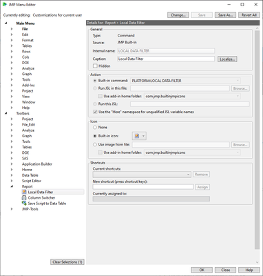

You can assign your own shortcuts from View / Customize / Menus and Toolbars

Ah,
Platform: Local Data Filter
thanks, very convenient :)

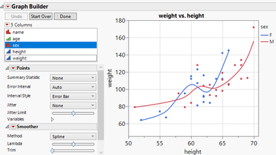

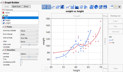

show the control panel:
show control panel(1)

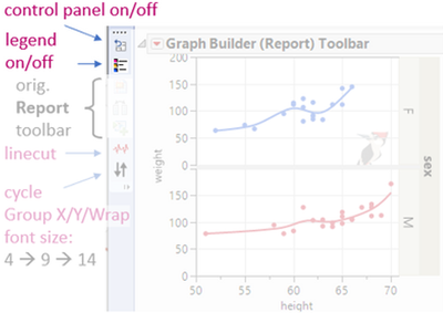

Here is an Add-In which adds Shortcut Icons to the Report Toolbar
- to open/close Control Panel
- to show/hide the legend
Graph Builder Toolbar
