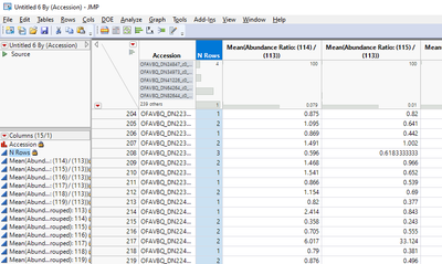

Added bold to important part. This solution could work if you are only interested in specific columns in the data: abundances grouped and accession. You would end up with something like this:
Also if one of the tables is "master" from which you would take other information from, you could join back to that
