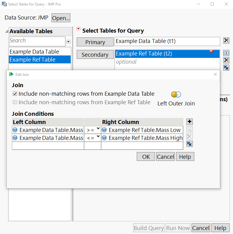

Re: join data based on approximate time stamp
Another idea that you might wish to check is using JMP Query Builder to do "fuzzy" joins.
I looked at this for someone that wanted to identify chemical components that are within a certain range of mass from mass spectrometry.
I have attached 3 tables as an example. The Joined table has class from the Ref table where Mass in the Data table is within the range of Mass Low and Mass High.
I am happy to provide more guidance if you think this solution would be useful.
This is how the fuzzy join is defined in JMP Query Builder:
