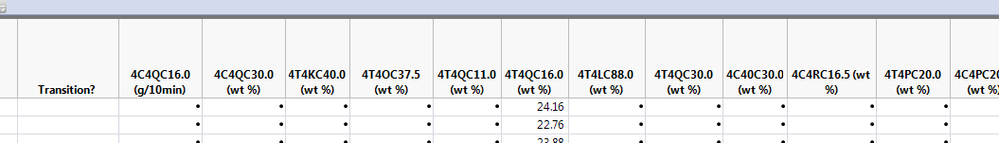

Hi, is there a script for me to select the last 10 columns in my table (the ones after "Transition?") and add ".Cv" at the end of the original column name?
I tried writing my script but it did not work:

Here is a simplified version of your code that will add ".Cv" to the end of the specified columns
dt = Current Data Table();
For( i = 11, i <= N Cols( dt ), i++,
	Column( dt, i ) << Set Name( (Column( dt, i ) << Get Name) || ".Cv" );

It works! Thank you so much !
