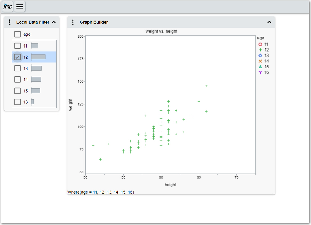

You did not mention which version of JMP that you currently use.  In the latest version, JMP 15, Graph Builder with a Local Data Filter is only partially implemented.  For example, using the JMP Sample data table Students,  while an active window in JMP, when I select an age group, the graph points elements are dynamic. If saved as interactive HTML, however, other elements like a smoother is not.  Below is a graphbuilder plot using age as an X Group. In JMP, only the item I selected and its smoother is shown; with interactive HTML, the non-dynamic elements are fixed. More discussion below the pictures.
In JMPIn JMPInteractive HTMLInteractive HTML
If you only have point elements, then try this script. The key is to select all items in the list, then save the graph as interactive HTML. Then on the web you can select the points. Note the legend and note (the where statement)  are not dynamic.  See the HTML output below the script. Given that, there are multiple methods to create a web view to select a picture.
Please provide a few more details, like which JMP version you use, and whether your selection list is long, do you want all views in a horizontal list, or only one view at a time, etc.

For Interactive HTML you might get better results in this case by simply unchecking the "Include" checkbox allowing the data filter to simply hide/show parts of the entire dataset rather than exporting only the included portion (including and excluding rows is a feature of JMP Live).  After export you are only hiding/showing a subset of the originally included rows, not the entire dataset.  However our intention is for the initial display of the HTML output to match JMP so if that isn't the case it is a bug.  After interaction, the two might be different due to the "Include" checkbox.
