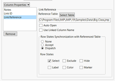

and activate either dispatch or accept for the row state Select:

Then switch form "Dispatch" to "Accept" mode.
Re: interaction between two data tables
it works by changing "row States Synchronization with Referenced Table" in link reference of data table A from Dispatch to Accept.
