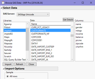

The best way I know of to get SAS custom formats into JMP (as value labels) is to use File > SAS > Browse Data from JMP.  This requires you to make a connection to local SAS or SAS running on a server somewhere.  You'll get an interface that looks like this:
You can then select the library and data set that you want to import into JMP.  When you click Import, JMP will import the SAS data set, and if it sees that the data set contains user-defined formats, it will attempt to convert them to JMP value labels.  In order for that to work successfully, the user-defined formats need to be contained in a format catalog that SAS is configured to look for formats in, which may require you to have LIBNAME and FMTSEARCH statements in the autoexec.sas file that SAS uses when it starts up.  But, if the format information can be found, JMP will do its best to map the user-defined formats to value labels.

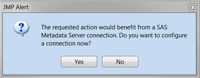

Thanks. That clears things up a little. However, every time I select Browse File > SAS > Browse Data I receive the JMP alert:
After selecting "no" I can get to the browse data window but there are no datasets showing in the Work library. This is despite having SAS running concurrently with datasets visible in the work library from SAS's explorer window.
I have reviewed the documentation on setting up JMP to interface with SAS through the preferences window but it is not clear to me if there is some way to setup the link with SAS on my local machine.
Any idea if there is a setting to address this?
Thanks,
