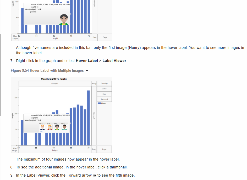

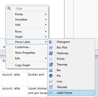

You can use Label Viewer
From Using JMP > JMP Reports > Customize Hover Labels in JMP Graphs > Add Graphs or Images to Hover Labe... you can find section Example of Displaying Multiple Images in a Hover Label

In earlier versions of JMP, just a single image could be displayed.
The Label Viewer was added in JMP 16:
