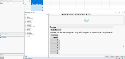

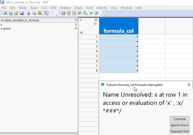

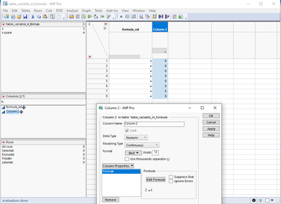

Can someone tell me how I'm supposed to use table variables in the formula editor? Say I have a variable x with value 3, I open the editor and create a column with value 2*x. In the editor the preview nicely shows that this would return values of 6 for the entire column. However, after applying it this is not the actual result but I'm getting a Name unresolved error instead.
This is not intuitive at all. I have been able to get it to work in the past but every time I'm struggling again.

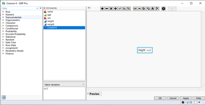

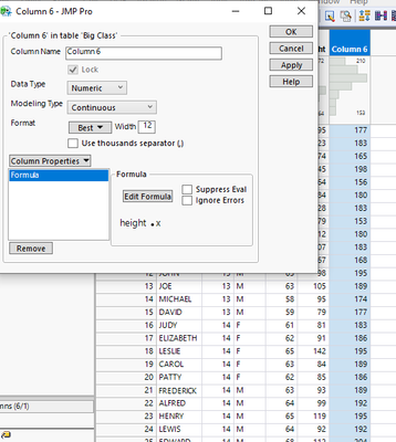

Maybe we are using different JMP version (I'm using JMP16.2) but I do see both column and table variable selection in formula editor
with your data
Using JMP > Create Formulas in JMP > Refer to Data Table Values in Formulas (jmp.com)
with your data

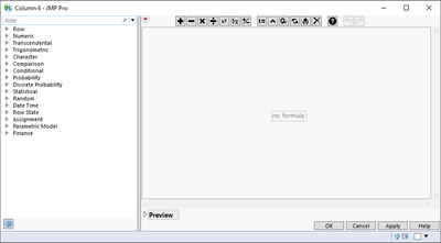

thanks for the reply, for some reason this panel was completely hidden for me. When I click on the table variable to create the formula it actually works.

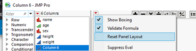

To me it looks like it might be collapse. This is my window:
I can drag the line between functions and columns and it will hide column selection
but I can drag it back from the left line where column selection should be. You can also use red triangle next to formula selections and reset the panel layout
