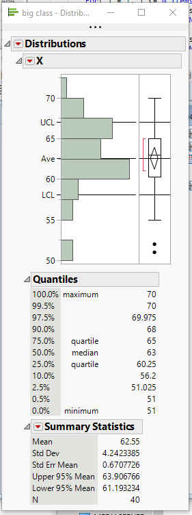

Here is a simple example that
  1. Populates the Control Limits for a column
  2. Runs a Distribution Platform
  3. Adds the Control Limits from the displayed column on the graphical output

dist = Distribution( Continuous Distribution( Column( :X ) ) );
// Extract the Control Limits from the column
contLimits = :X << get property("Control Limits");
// Parse through the returned Limits to get the LCL, UCL and Avg
contLimits=char(contLimits);
found=contains(contLimits,"XBar");
contLimits=substr(contLimits,found+5);
found=contains(contLimits,"avg");
contLimits=substr(contLimits,found+4);
theAvg = num( word(1,contLimits,")"));
found=contains(contLimits,"LCL");
theLCL = num( word(1,contLimits,")"));
found=contains(contLimits,"UCL");
theUCL = num( word(1,contLimits,")"));
// Add reference lines to the graph with the Control Limit values
report(dist)[AxisBox(1)] << add ref line(theLCL,Solid,Black,"LCL");
report(dist)[AxisBox(1)] << add ref line(theUCL,Solid,Black,"UCL");
report(dist)[AxisBox(1)] << add ref line(theAvg,Solid,Black,"Ave");
