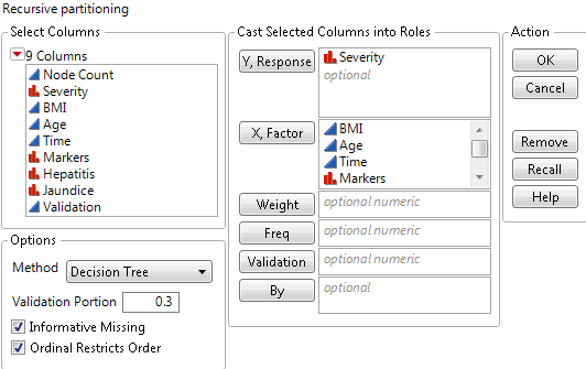

How can I identify which rows(observations) are my validation points when my target variable is category variable when I use random selections? such as example from https://www.jmp.com/support/help/14/example-of-profit-matrix-and-decision-matrix-rep.shtml#1276835 I know for continuous target variable, I could select rows from predict vs actual plot to know which observations are labeled as validation/training data. but I could not find this for categorical target variable. thanks

You're using the "Validation Portion" option in the Partition launch dialog.
Unfortunately, I don't see a way to identifiy which rows are used for validation with this method.
If you've got JMP Pro, I agree with @Peter_Bartell. You can create a Validation column to specify which rows are used for validation.

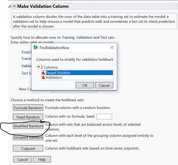

The other thing I'll suggest is if you have a categorical response, a general best practice wrt to creating the Validation column in JMP Pro's Make Validation Column capability is to select the Stratified Random option circled below, then select your target variable. This will force the randomization % you choose to apply to each level of the categorical variable...which helps prevent against model bias.

Thanks for your reply. But "the other the validation column" could not be found in the data or result when it is random split for categorical variable.  Row selections only could be used for numerical target variables when result show plot of actural vs predicted (by highlighting data points from plot) . But for categorical target variable, the results have ROC, Matrix etc, and I could not identify which rows are from validation part, which rows are from training parts...

Just wondering how JMP split data randomly ( in the model of Random forest, boosted tree etc.) and from JMP random's split, I could identify rows/observations as Training/Validation for categorical target variable.
from Jeff's post, looks like JMP didn't have a way to identify them.
