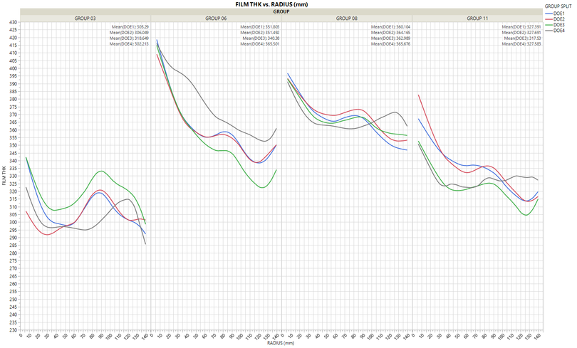

how to generate a data table through a graph which is a plot of some data?
if I only have a photo graph which is a plot of some data, but not have a its original raw data. can help to suggest how to generate a data set use this graph (>100 data points per each curve)?My purpose is to generate a data set that can represent its profile, and join with others then can do a new plot to combine all togehter.can use jmp script or through its basic function tools? thanks a lot.

I suggest the following expansion on the solution given in your recent posting on reading the data from a graph with a single blue line listed here
  1. Cut and paste each of the 4 graphs into separate images and then save them as .jpg files
  2. Run the script provided by @Craige_Hales on each of the different colored lines.  Craige''s script allows for the capturing of the line, based upon the color specified by a MicroSoft Eyedropper reading of the RGB color definition.
  3. Then you will be able to put together each of the columns of data derived, into a new data table.

since new plot have four groups with different color, so could help to suggest how to modify the script as I am a new comer.
