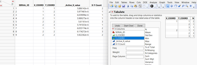

I am fairly new to JMP. I have a data table here
I like to have X count column to show the count number of the value in X-COORD, similar thing, X-Y Count column to show the count number of the value [X-COORD, Y-COORD].
in fact, I can get the count number by tabulate. but I like to show the numbers in column in order to do next level calculation.
I really appreciate if you would do me a favor to show which formula is supposed to apply in column of X count, which formula for X-Y count. thanks

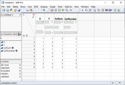

Re: how to count value in columns
Summarize + Update is the easiest option (or you can do interactive drag and drop if you can get it to work). You can also use Col Sum()
Col Sum(1, :X, :Y)
Col Number should also work, but you have to make slight modification to Thierry's suggestion
Col Number(:X, :X, :Y)
-Jarmo

sorry for my unclear statement. my intention is to look X-COORD and Y-COORD as matrix, the number in X-Y Count column is my purpose. I am looking forward to your help on the formula.
txnelson
Fastest and easiest way is to use:
     Tables=>Summary
and specify X-COORD and Y_COORD as grouping variables, and do not specify a statictic
Then use
     Tables=>Update
from your original data table and specify the summary table as the update table, matching on S_COORD and Y-COORD
Jim
jthi
Col Sum(1, :X, :Y)
-Jarmo

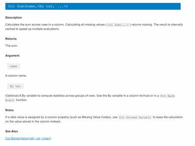

ReliabilityWolf
Level III
@jthi this is a wonderful solution. thank you.  by the way, I am rethinking why I failed to select col sum(1,:X,:Y). based on JSL syntax reference below, the first argument is name, a column name. but you use 1. this is out of my thinking.
jthi
Using expressions inside those functions might disappear at some point if JMP decides to do that (in my opinion it would make them 1000 times worse if they did that), but you could add new column with only values of 1 to avoid that (if it were to happen). Here is my wish list item which attempts to "prevent" JMP for making the horrible mistake of "fixing" that and making it a feature not an unintended behaviour
Make using formula expressions in Set Each Value and using expressions as first argument in Col stat...
-Jarmo
