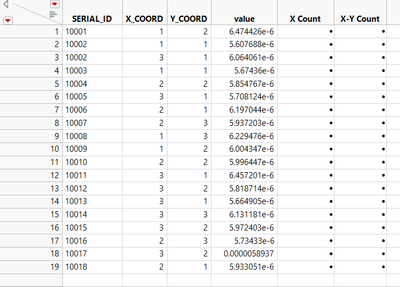

I am fairly new to JMP. I have a data table here
I like to have X count column to show the count number of the value in X-COORD, similar thing, X-Y Count column to show the count number of the value [X-COORD, Y-COORD].

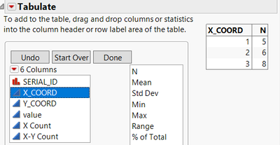

in fact, I can get the count number by tabulate. but I like to show the numbers in column in order to do next level calculation.

Summarize + Update is the easiest option (or you can do interactive drag and drop if you can get it to work). You can also use Col Sum()
Col Sum(1, :X, :Y)
Col Number should also work, but you have to make slight modification to Thierry's suggestion
Col Number(:X, :X, :Y)
-Jarmo

sorry for my unclear statement. my intention is to look X-COORD and Y-COORD as matrix, the number in X-Y Count column is my purpose. I am looking forward to your help on the formula.

Fastest and easiest way is to use:
     Tables=>Summary
and specify X-COORD and Y_COORD as grouping variables, and do not specify a statictic
Then use
     Tables=>Update
from your original data table and specify the summary table as the update table, matching on S_COORD and Y-COORD
Jim
jthi
Re: how to count value in columns
Col Sum(1, :X, :Y)
-Jarmo
ReliabilityWolf
Level III
@jthi this is a wonderful solution. thank you.  by the way, I am rethinking why I failed to select col sum(1,:X,:Y). based on JSL syntax reference below, the first argument is name, a column name. but you use 1. this is out of my thinking.
