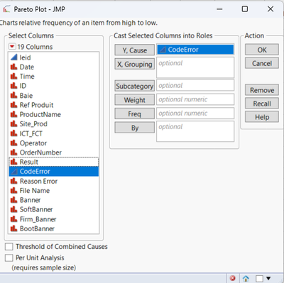

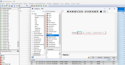

I am trying to create a Pareto diagram in JMP, but in my data table, I don't have the frequency of code errors (which are defined as a list of integers from 0 to 1010). I am looking for a way to count these directly in JMP as a new column. I found the "Row > Count" function in the formula section, but I don't know how to use it

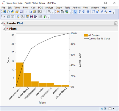

Depending on your data, maybe Col Sum() or Col Number()? Also if you just need the diagram you might be able to do the calculation directly in Graph Builder (or Pareto Plot) or you might want to utilize Summary table and create report from that.
