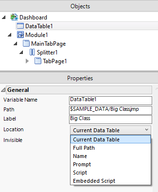

Use Show Properties:
and then change the setting for DataTable1 to Current Data Table:
