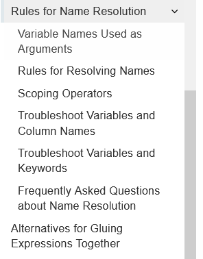

Also remember to see more topics by pressing arrow in the help page
or using left side menu
