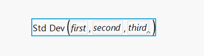

You're looking for the "Std Dev" function.
https://www.jmp.com/support/help/en/18.0/#page/jmp/statistical-functions.shtml#
See attached data table as well.

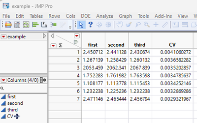

If you are attempting to calculate the Coefficient of Variation for each row, it would be:
names default to here(1);
dt=
New Table( "example",
	Add Rows( 7 ),
	New Column( "first",
		Numeric,
		Set Values(
			[2.4507119999999998, 1.267139, 2053.4589999999998, 1.752283, 1.108177,
			1.2322379999999999, 2.4711460000000001]
	New Column( "second",
		Numeric,
		Set Values(
			[2.441128, 1.258429, 2062.3409999999999, 1.7619819999999999,
			1.1137779999999999, 1.225236, 2.4654440000000002]
	New Column( "third",
		Numeric,
		Set Values(
			[2.4306739999999998, 1.260132, 2067.8389999999999, 1.763598, 1.115453,
			1.2322379999999999, 2.4567939999999999]
dt << new column("CV", formula( stddev(:first,:second,:third)/mean(:first,:second,:third)));
