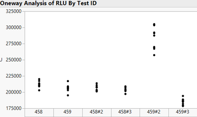

hello, the default X-axis sequence of fit-Y-by-X plot is 458/459/458#2/458#3/459#2/459#3. How to set the sequence order to 458/458#2/458#3/459/459#2/459#3 ?  Thank you!

To do this, you need to change the Value Order for the Column you specified as the X column in your Fit Y by X
  1. Go to the data table that you specified to use in your Fit Y by X.
  2. Right click on the column header for the column you specified as the X column in the Fit Y by Y and select Column Properties=>Value Order
  3. Using the Dialog Box that is displayed, move the values found in the column to the order you want them to be in the graph
  4. Click OK
  5. If the order did not change on the chart, go to the red triangle in the chant and select   Redo=>Automatic Recalc
For the remainder of the session, all displays of the X columns values will use the order specified by the Value Order column property.  If the data table is saved, the value order will persist from session to session.

Use Value Orde column property and define order with that
  4. Click OK
