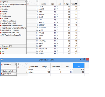

how do i use USL and LSL values saved in other table and use it in script generation capability analysis?

Re: how do i use USL and LSL values saved in other table and use it in script generation capability analysis?
Depending on what your code requires, there are several ways to do this. But the JMP doc should give some ideas:
Entering Specification Limits
I recommend referencing Associative Arrays in the Scripting Guide.
Thank you! this reference was of great help!
have a great day!
