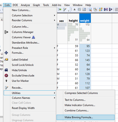

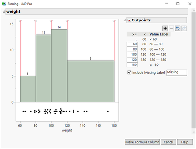

You can do it by utilizing binning formula for example

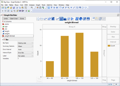

Then create bar chart in Graph Builder

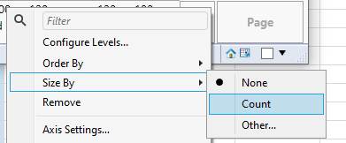

And change X-axis Size By to Count
Or use other column for that purpose by using Other... option
