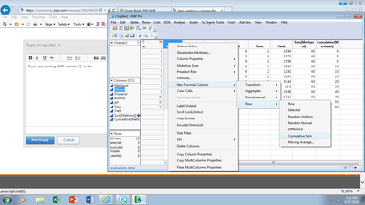

If you are running JMP version 12, if you right click on the column header field in the data table, the New Formula Column -> Row -> Cumulative should work without having to resort to JSL. See below:
