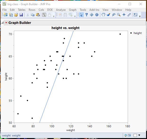

Hi,
I am using graph builder for visual representations of my data, combining several variables into one graph with an x-y scatter. I want to add a simple linear line of best fit but force it to go through 0,0 - this seems like a pretty fundamental feature so am I missing something? I have been through every option I can think and tried both methods of creating the line of best fit (line of fit, and smoother with max lambda) but nowhere is the option to adjust intercept of the line!
I know I can do it with bivariate fit Y by X, or fit model, but if I've got two variables fields i have to do my analysis by both of these and I'll end up with 4 separate graphs instead of a nice overlayed graph.
Many thanks

I am not aware of an option within Graph Builder to force the intercept through zero.  However, a simple little script can be added to the Graph Builder, that will draw the line.
Names Default To Here( 1 );
dt=open("$sample_data/big class.jmp");
gb = Graph Builder(
	Size( 528, 456 ),
	Show Control Panel( 0 ),
	Variables( X( :weight ), Y( :height ) ),
	Elements( Points( X, Y, Legend( 3 ) ) )
/*Simple Linear Regression: y = intercept + beta * x + error*/
report(gb)[framebox(1)]<<add graphics script(
goodRows = dt<<get rows where(excluded(rowstate(row()))==0);
y = dt:height[goodRows];
X = dt:weight[goodRows];
{Estimates, Std_Error, Diagnostics} =
Linear Regression( y, X, nointercept );
List1 = { 0, 0};
List2 = {};
insert into(List2, max(x));
insert into(List2, estimates[1]*max(x));
pen color(blue);
line(List1,List2)
Jim
