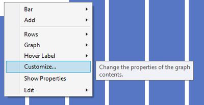

Maybe adjusting Width Proportion is enough. Right click on graph builder and select customize:

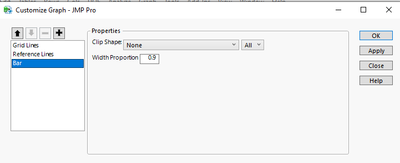

Select Bar on the left and modify Width Proportion:

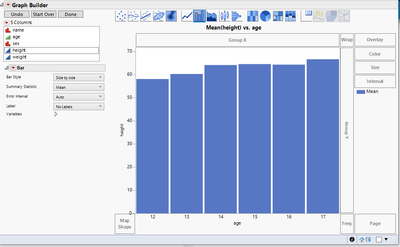

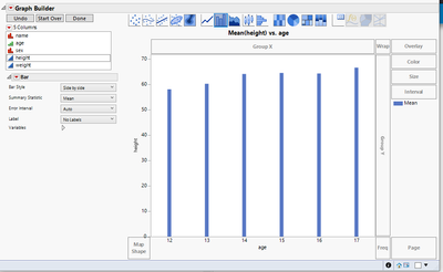

Width proportion 0.1:
Width proportion 0.95:
