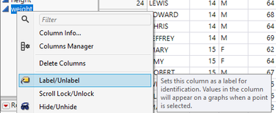

hii, two questions:
  • I tried to put name labels on my graph data, but when I use "Label by Row," I get only the row number. Any solution?

For the first question: enable Label on the columns you wish to show
-Jarmo
-Jarmo

Re: graph builder: label by row and error bars
thank you
you made my life easier
