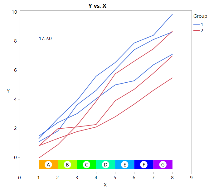

getting lefthand offset between beginning of picture box and framebox from graphbuilder plot
JMP Pro 17.2
I have a plot where I want to use both overlay (to separate lines) and color (to color related lines the same way). This works great, but I lose all colors when extracting the framebox. I can keep the colors by grabbing the picturebox, but I don't know how to calculate the left offset in the plot before where the x-axis begins. It seems like I should use the y-axis width plus the y-axis label (text edit box) however the text edit box returns a width of -1.
Is there a good way to calculate the left-hand margin or (better) a way to keep all the coloring in the framebox?

Interesting approach! If you can keep everything inside the frame box, it will be easier...just use with the graph's coordinate system. I suspect you are going to be fighting with the integer coordinate system for the displayboxes as well as trying to find the proper origins; you also will disconnect the graph from the axes (dragging the scales, etc won't work.)

Report( gb )[framebox( 1 )] << addgraphicsscript(
	Text( {1, 8}, JMP Version() );
	For( here:x = 1, here:x < 8, here:x += 1,
		Fill Color( HLS Color( here:x / 9, .5, 1 ) );
		Rect( here:x, -.2, here:x + 1, -.8, 1 );
		Fill Color( "white" );
		Circle( {x + .5, -.5}, .25, "FILL" );
		Text Color( "black" );
		Text Size( 12 );
		Text( center justified, {x + .5, -.65 /*vertical centering depends on text size*/}, Substr( "ABCDEFG", x, 1 ) );
Add a graphics script to the framebox to make custom displays.Add a graphics script to the framebox to make custom displays.
