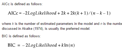

and this deviance would be the exact same as the -2LogLikelihood in the AICc equation?

Thanks for helping with this (On Saturday no less).  Just so I'm clear, If I do the steps below, I should get something proportional to JMPs AIC?
Names Default to here(1);
k =[0, 1, 1, 2, 2];
n=500;
nulldev = 1100;
devs = [1100, 1099, 1098, 1097, 1096]; //calculated from (1-dev.ratio)*nulldev
fake2L = nulldev-devs;
AIC = -fake2L+2*k+2*k:*(k+1):/(n-k-1);
*Edit* changed AIC to be correct
Vince Faller - Predictum
Re: getting AIC/likelihood from model coefficients
The first term in the equation should be negative. As the deviance decreases, AICc should get better (smaller).
