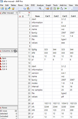

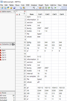

original table
 after moved

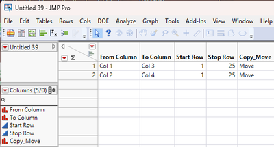

Then I would make it as straight forward as possible and create a config table something like
Which makes your JSL pretty simple, something like:
