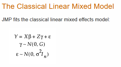

Now look at the description of "Classical Linear Mixed Model" on Mixed Models and Random Effect Models . Here is a screenshot of the formula. For such data, observations are not independent. The model allows modeling the correlation among observations.
