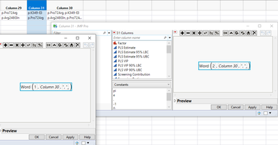

  You should probably create two columns named something like Mutation 1 and Mutation 2 or Mutation N if there are N such mutations, then you can use a column formula with the formula using
Word(n, s, delim)
Where n would be the first word for the first mutation and so on, and s is the existing mutation column. The delim that you'd use is ", " since the mutations are separated by a comma and then a space. That should get you what you want.
Hope this helps!,
DS
Edit: I should also add that the other rows where there's only one mutation will show up only in the first Word(1, s) column and the second in the second and so on. There will be empty rows for Mutation 2 column if there's only one mutation in the gene.

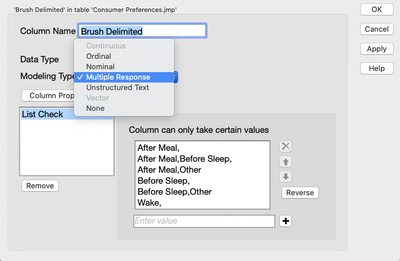

I think a solution depends on exactly what you want to do with the data but the situation you find yourself in is why JMP has Multiple Response as a Modeling Type.
This choice will treat each comma separated value in the column as an individual value. It works well in Distribution, the Data Filter, Categorical and some other places. It works in Graph Builder in JMP 16.
Multiple Response values frequently come up in surveys where a respondent is given the chance to choose more than one answer to a question (e.g., what magazines do you subscribe to?).
Tell us more about how you want to use the values there and maybe we can make more suggestions.
