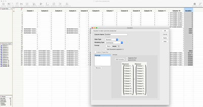

#i have this attached table where the dates are submitted at the end of 12 different production steps (here column 1 to column 12). each row represent a unique production object. so i have 27 prod objects, each going through 12 prod steps; and hence have 12 prod dates. #I need to find the following: the duration required for the prod object to go from step1 or some other step to last completed step. Depending on the object: the last completed date can be step 12 or anything between step 2 and step 12. same goes for the start date, it does not necessarily start from step 1, so it can start from any step like 8 or 10 and then end at step 12. THE END DATE IS ALWAYS LATER THAN THE START DATE. # i need to write a function that would find the duration for all production objects/rows whether the first step is (1 to 12 ) and the last completed step is (1 to12) . please note the last completed date is not necessarily current/today date. it can be any date in the past/present/future. i am not sure how to script this write this function.

hello @txnelson i have uploaded the data table

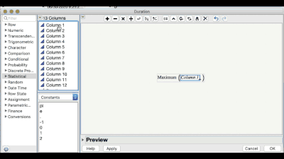

The Minimum() and Maximum() functions will work for you here.
NB: In the Formula Editor you can click on Column 1 and shift-click on column 12 and drag them into the argument for Minimum() and Maximum().
