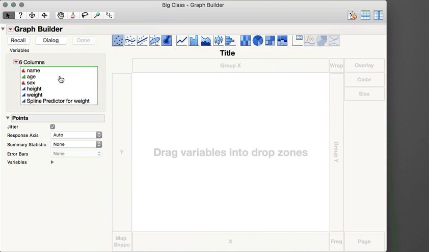

It seems neither Graph Builder nor Fit Y by X will extend a smoother out of the box. There is a way to this, but it requires a few steps:
  1. Launch Fit Y by X with your Y and X, and fit a spline of your choosing (Red Triangle > Flexible > Fit Spline).
  2. Go to the Red Triangle for the smoothing fit > Save Predicteds. JMP will not just save the predicted Ys, but a prediction formula using the Spline Eval() function and a coefficient matrix.
  3. Launch Graph > Graph Builder, add your predictor as the X, and the new saved formula column as the Y
  4. Toggle the Formula graphing element
  5. If you want to have the original points plotted, drag your original Y column to the drop zone to add a variable to Y, and then shift-click the Points element (or drag the points element to the plot).
  6. You will be plotting points for both the formula column as well as the original Y; if you don't want this, expand the controls for the points and uncheck the box for the spline predictor under variables.
Now, whether or not this is a good idea of course depends on the data and how flexible that model is. In the example below this particular extrapolation returns a prediction of -29,714 lbs for someone 0 inches tall :)
