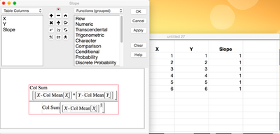

I'd like to know what is the excel 'slope' formula in JMP.    (not 'Bivariate' analysis menu)
If JMP does not have a formula format for 'slope',  would you help me to make a JMP formula as below?
xyslop
11-
22?

You can create a column formula for calculating the slope as follows:
  1. Create a new numeric column entitled Slope.
  2. Enter the formula for the slope as shown below.
  3. The Col Sum and Col Mean functions are found under the Statistical functions.
7492_Screen Shot 2014-10-27 at 11.28.03 AM.png7492_Screen Shot 2014-10-27 at 11.28.03 AM.png
Col Sum( (:X - Col Mean( :X )) * (:Y - Col Mean( :Y )) ) /
Col Sum( (:X - Col Mean( :X )) ^ 2 )
