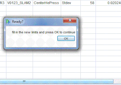

Im doing sometion similar and suffer from the same issue.
The modal window was my initial solution as well.. Unfortunatelly it dosent work.
When the new window openes it prevents access to the data tables (it remains on top):
Is there a way to bypass the on-top default of the modal window?
Or a better idea fo implementation?
