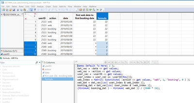

Re: day difference in the same column of different scenarios
I think the following formula will do for scenario A:
It is not yet optimized, but may show you how things like this can be done.
It uses some simple jsl in a formula, step by step.
Please see full script for table generation:
New Table( "20210404_user_web_booking_matrixexample",
	Add Rows( 12 ),
	Compress File When Saved( 1 ),
	New Column( "userID",
		Numeric,
		"Continuous",
		Format( "Best", 12 ),
		Set Values(
			[2523, 2523, 2523, 2523, 2523, 2523, 2540, 2540, 2540, 2540, 2540, 2540]
		Set Display Width( 66 )
	New Column( "action",
		Character( 16 ),
		"Nominal",
		Set Values(
			{"web", "web", "booking", "booking", "web", "booking", "web", "web",
			"booking", "booking", "web", "booking"}
		Set Display Width( 73 )
	New Column( "date",
		Numeric,
		"Continuous",
		Format( "y/m/d", 12 ),
		Input Format( "y/m/d" ),
		Set Values(
			[3608409600, 3609273600, 3610310400, 3611260800, 3613852800, 3616531200,
			3647462400, 3647548800, 3647635200, 3647721600, 3647808000, 3647894400]
		Set Display Width( 92 )
	New Column( "first web date to first booking date",
		Numeric,
		"Continuous",
		Set Values( [22, 22, 22, 22, 22, 22, ., ., ., ., ., .] ),
		Set Display Width( 150 )
	New Column( "formula",
		Numeric,
		"Continuous",
		Formula(
			Names Default To Here( 1 );
			dat_vec = :date << get values;
			web_vec = :action << get values;
			user_vec = :userID << get values;
			user_index = user_vec == :userID[Row()];
			web_index = Matrix(
				Substitute( :action << get values, "web", 1, "booking", 0 )
			web_dat = dat_vec[Loc( user_index & web_index )];
			booking_dat = dat_vec[Loc( user_index & !web_index )];
			(Minimum( booking_dat ) - Minimum( web_dat )) / (3600 * 24);
		Set Selected
Georg
Thank you Georg! It works. Could you explain to me the logic behind this script? I'm not that familiar with Matrix and Loc here.
Do you happen to have the solution for scenario 2?
Thank you!

joann
Level IV
It works! Thank you very much Georg! Will learn from the link of Matrix and Loc. Really appreciate your help.
