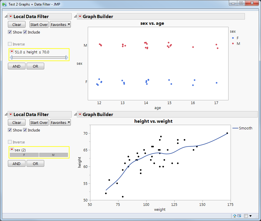

pmroz
Re: data filter for several graph from a same data table
Try something like this:
dt = open("$sample_data\Big Class.jmp");
nw = new window("Test 2 Graphs + Data Filter",
	vlistbox(
		dt << Graph Builder(
			Size( 518, 445 ),
			Show Control Panel( 0 ),
			Variables( X( :age ), Y( :sex ), Overlay( :sex ) ),
			Elements( Points( X, Y, Legend( 9 ) ) ),
			Local Data Filter( Add Filter( columns( :height ) ) )
			Size( 526, 451 ),
			Variables( X( :weight ), Y( :height ) ),
			Elements( Points( X, Y, Legend( 5 ) ), Smoother( X, Y, Legend( 6 ) ) ),
			Local Data Filter( Add Filter( columns( :sex ) ) )
