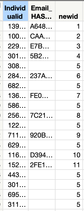

joann
Level IV
Re: create new id to deal with multiple to multiple relationship
Hi Jarmo, I forgot to mention that in the email column there are some rows having empty cells, meaning some individualID does not have anything populated under email column. I found that the current script will consider all individual ids having no emails as the same new id. could you help adjust the script to avoid this kind of situation? Thank you!

joann
Level IV
Hi Jarmo, below is an example. you can see many rows having empty email are all grouped as newid 5. If the individualID is not overlapped with other groups, those without emails should each have their own newid. Thank you!
jthi
Couldn't replicate your results (most likely you have different individual ids on the one starting with 308....)
Does the result from this look correct?
