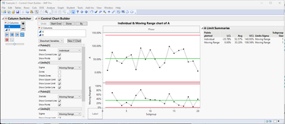

hi,
I have an IMR control chart with the column selector on about ten variables for Y axis
all variables do not have the same format for decimals and the same format (fixed decimal, percentage, ...).
I can't get the format I want for each Y variable
how to do it with jsl?
best regards

Here is an example of setting the number of decimals based upon the column format, when the column switcher changes.
Names Default To Here( 1 );
dt = New Table( "Example",
	Add Rows( 20 ),
	New Column( "A",
		Numeric,
		"Continuous",
		Format( "Percent", 12, 2 ),
		Set Values(
			[0.0754692861810327, 0.752831102814525, 0.432255176594481, 0.341968776658177, 0.568129215855151,
			0.660923485411331, 0.105864432407543, 0.915830883430317, 0.493037405889481, 0.848509776871651,
			0.502906230278313, 0.184636627091095, 0.356515710474923, 0.979479612084105, 0.720729062333703,
			0.824798582820222, 0.880037358496338, 0.396357897669077, 0.424773458158597, 0.0499309413135052]
	New Column( "B",
		Numeric,
		"Continuous",
		Format( "Percent", 12, 3 ),
		Set Values(
			[0.88264535064809, 0.856779424706474, 0.922006396111101, 0.225065165199339, 0.0619992383290082,
			0.405686405720189, 0.784316523466259, 0.523665967164561, 0.586588164092973, 0.281117314239964,
			0.283934285165742, 0.65784368221648, 0.944990600459277, 0.967821644386276, 0.798449326306581,
			0.925142117775976, 0.925621940754354, 0.363795479293913, 0.396030477480963, 0.41240519634448]
ccb = Control Chart Builder( Variables( Y( :A ) ) );
cs = ccb << Column Switcher( :A, {:A, :B} );
Report( ccb )[axisbox( 2 )] << Format( "Percent", 12, 2 );
cs << set Script(
	theCol = cs << get current;
	theFormat = Char( Column( dt, theCol ) << get format );
	theDec = Word( -1, theFormat, ") " );
	Eval(
		Substitute(
				Expr(
					Report( ccb )[axisbox( 2 )] << Format( "Percent", 12, _dec_ )
			Expr( _dec_ ), Num( theDec )

Hi Jim,
It's good !
thanks for your answer.
