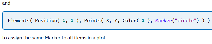

I wished there was a consistent marker control in Graph Builder.

The wish is from August (2025):consistent marker control in Graph Builder
It seems that someone else had the same wish, because here it is [1st part]!

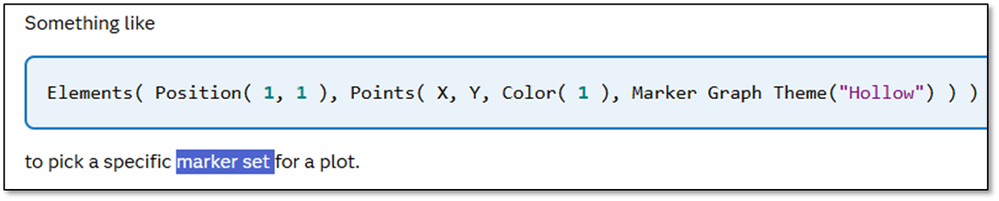

Looking at consistent marker control in Graph Builder , the new feature is exactly  proposed mode:
Very helpful will be the mode:
e.g. to generate the first graph with hollow markers and the second graph with filled markers.
or to use the left axis for hollow markers and the right axis for filled markers.

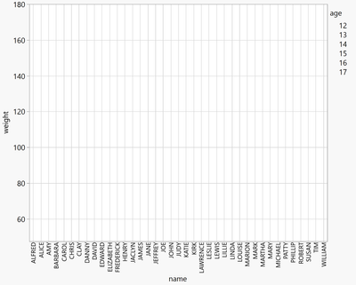

I just tried Type Properties( 0, "Marker", {Marker( "Hollow" )} ):
Names Default to Here(1);
dt = Open( "$SAMPLE_DATA/Big Class Families.jmp" );
Graph Builder(
	Variables( X( :name ), Y( :weight ), Color( :age) ),
	Elements( Points( X, Y, Legend( 1 ) ) ),
	SendToReport(
		Dispatch( {}, "400", ScaleBox,
			{Legend Model(
				1,
... which doesn't produce the expected result (a graph with hollow markers)  - but provides another cool option *)
*) cool really ?!??! Why?
Just save the code of the generated graph and find: Marker( "" ) . It can be used to hide a markers very easily/efficiently.
Type Properties( 0, "Marker", {Marker( "" )} )
can be used to hide all markers (almost too extreme: the user doesn't have any chance to change the marker  / show them ).
