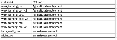

I am trying to convert rows grouped by a composite variable into a concatenated cell sepearated by a space based on the grouping variable.  Example:
into:
The code below creates a grouping column and a "N rows" column but i cant get the contents of the cells concatenated.

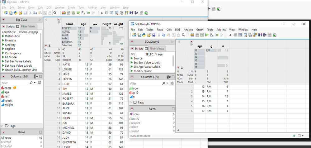

I like doing this with SQL Query from JMP table
Names Default To Here(1);
dt = open("$SAMPLE_DATA/Big Class.jmp");
dt_concat = Query(
	Table(dt, "t1"),
SELECT age, GROUP_CONCAT(sex) as g,
count(*) as n
FROM t1
GROUP BY age
You can also ignore duplicates by adding DISTINCT to the group concat
dt_concat = Query(
	Table(dt, "t1"),
SELECT age, GROUP_CONCAT(DISTINCT sex) as g,
count(*) as n
FROM t1
GROUP BY age
-Jarmo
